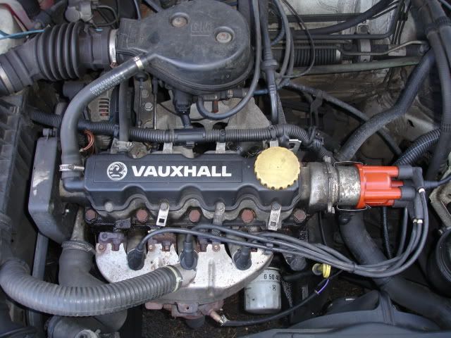

I asked this a while ago, and no one could answer. Someone said, it's easy to tell if I can see it. So here's a photo. It's a 1.4.
Sweet... thanks... Thought it was. Therefore it's a C1.4NZ.
Cause that's what I told the motor factors when ordering parts and now I've come to fit them, they don't fit!
Thanks for the quick and definite response!!
How do I know if it's 8v or 16v?? Apparently the cylinders look slightly wider but I have nothing to compare it to. Is there nowhere I can find out? I've looked at the registration document and mot certificate.
If I go to Halfords or somewhere, can they tap my reg into the computer and find out. Or can I find out somehow. Is the engine code written anywhere?? I only have an engine number on my reg doc.
and spi's only came in 8v form for all the capacity range, 1.3, 1.4, 1.6 and 1.8 nz range
and the 1.8?
The Corsa has never had a 1.3. The only 1.3 ever offered in the Corsa was/is the 1.3 CDti which is a diesel.
probably a nova then?
If it was in the Nova (Corsa A) then it wouldn't have even been an SPi, just a manual carb. Only SPi in the Novas was the 1.2 iirc.
