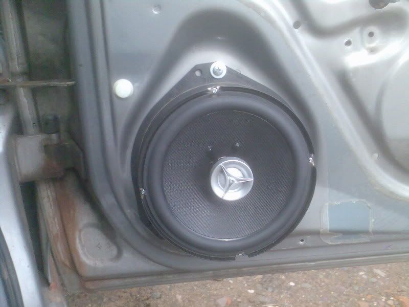

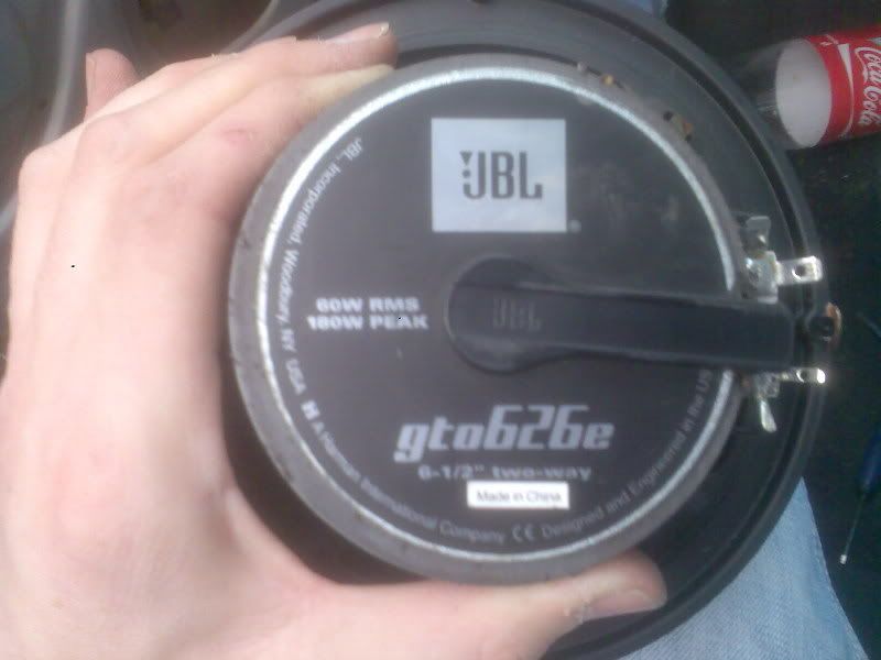

Little update, got my new speakers in today but did them a little differently than normal!
*new speakers

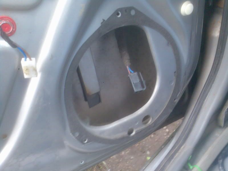

*got old speakers out to leave the holes in the doors

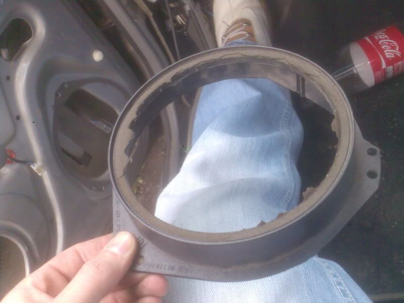

*destroyed the inners ( by cutting and snipping through the speaker structure under thr cone [in the circle cut outs]) to be left with the ring and a 3mm step-in that had the foam attached (to screw through, later pic)

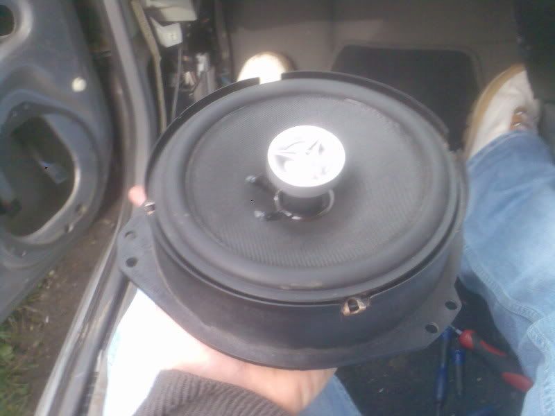

*sat new speaker inside - it was probobly about 1 mm too big but the side pegs sorted that out in next picture

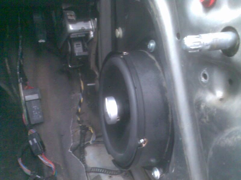

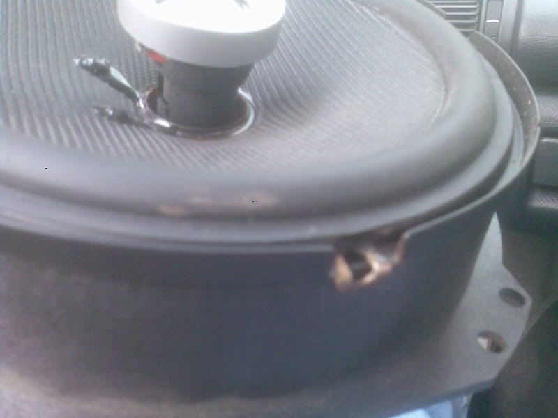

*folded over the tags to keep in position and screwd through the step-in with small screws to hold the speaker onto the door base
*all screwd in and wired up - 1 hour inc. dinner!
work and sound amazing and saved myself 100's of pounds from not buying speaker pods from halfrauds!
should be made a sticky and i should be given an award for saving people money! :D
*new speakers
lol, enjoy
(i should probobly note that getting a second or spare pair of speakers to try this on would be a good idea if you do not feel confident!) keeps me outta tha shizzel!

These side pegs...
Did you basically hacksaw into the outer ring, then fold them over?
Because, they dont seem to be there in the previous pic..
and
You havnt explained how they 'appeared'
Did you get the speakers from Ebay?

These side pegs...
No cutting of the new speakers was involved, onli cutting the old speakers out of the standards
and
The side pegs were on the speakers as standard, they stick out and i just folded them over!
