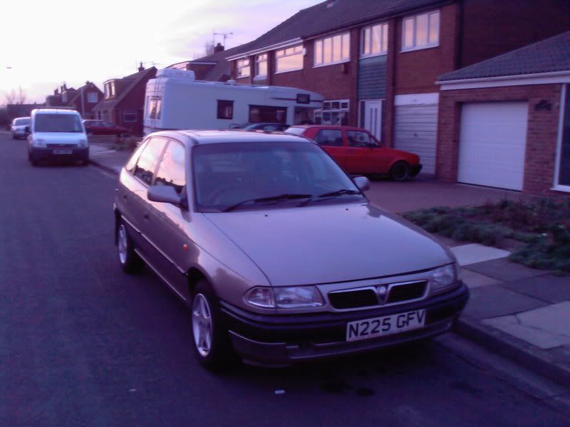

After owneing sevral vauxhalls in the past ive bought my 1st mk3 astra, well i swopped it for a seat cordoba, any ways its going to be a small project my plans are simple a 5dr Astra GSI, its got 100k on the clock but the inside is really clean no usual rip on drivers seat ect also this has an drivers and passangers Air Bag and a vaux CD player, its got an super quick 1.4 8v moto in which will be soon exiting the car and been replaced with a 2.0 8v engine cheaper than an x20xe conversion but parts are easier to find, soo them are my plans and here is a pic:
Alredy the brakes have faild but ive replaced the master cylinder and both front calipers and disk's for 1.6 16v ones (small improvment) :rolleyes:
soo what you all think i will be getting some more pic's up shortly :beer:
