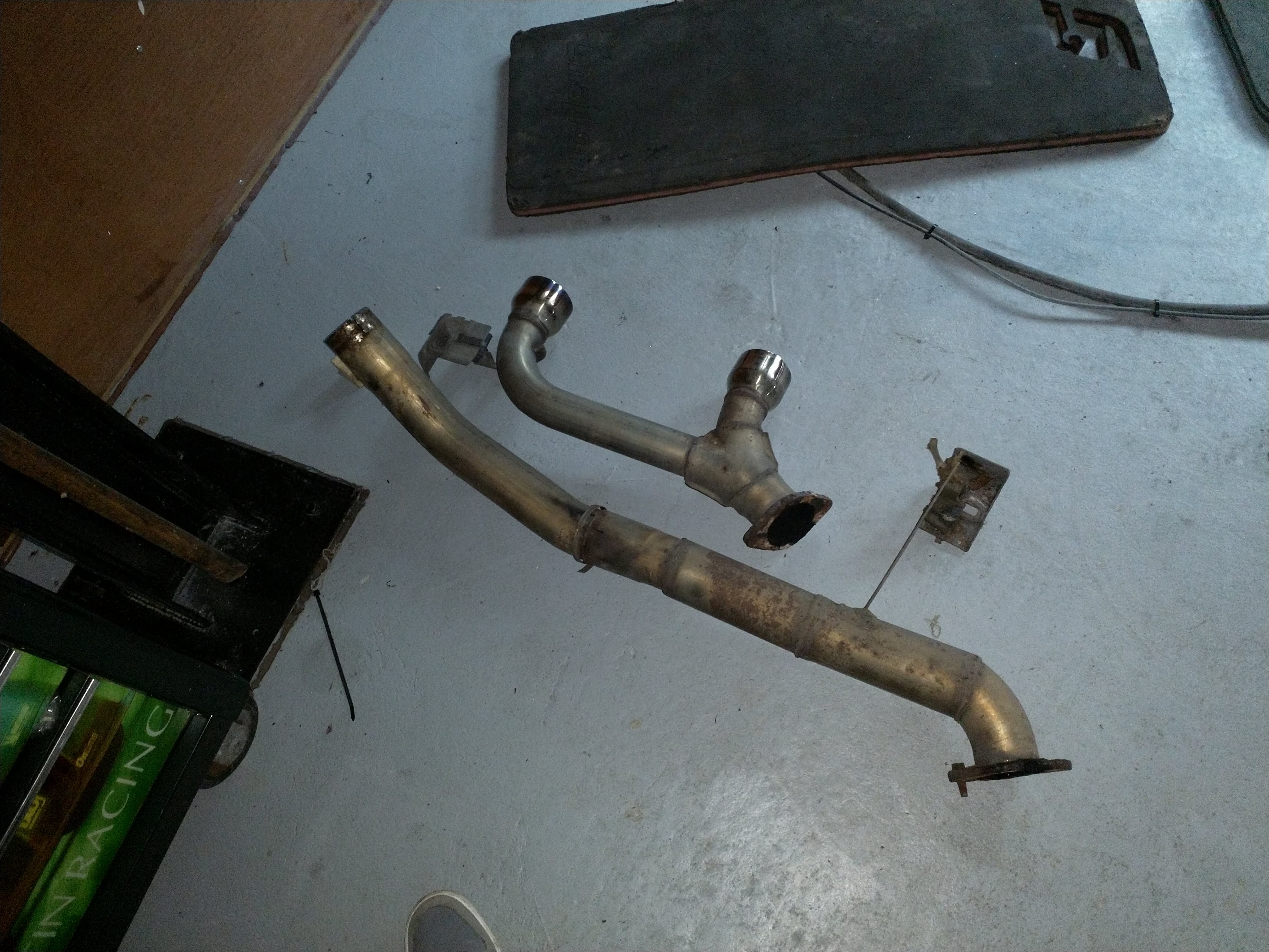

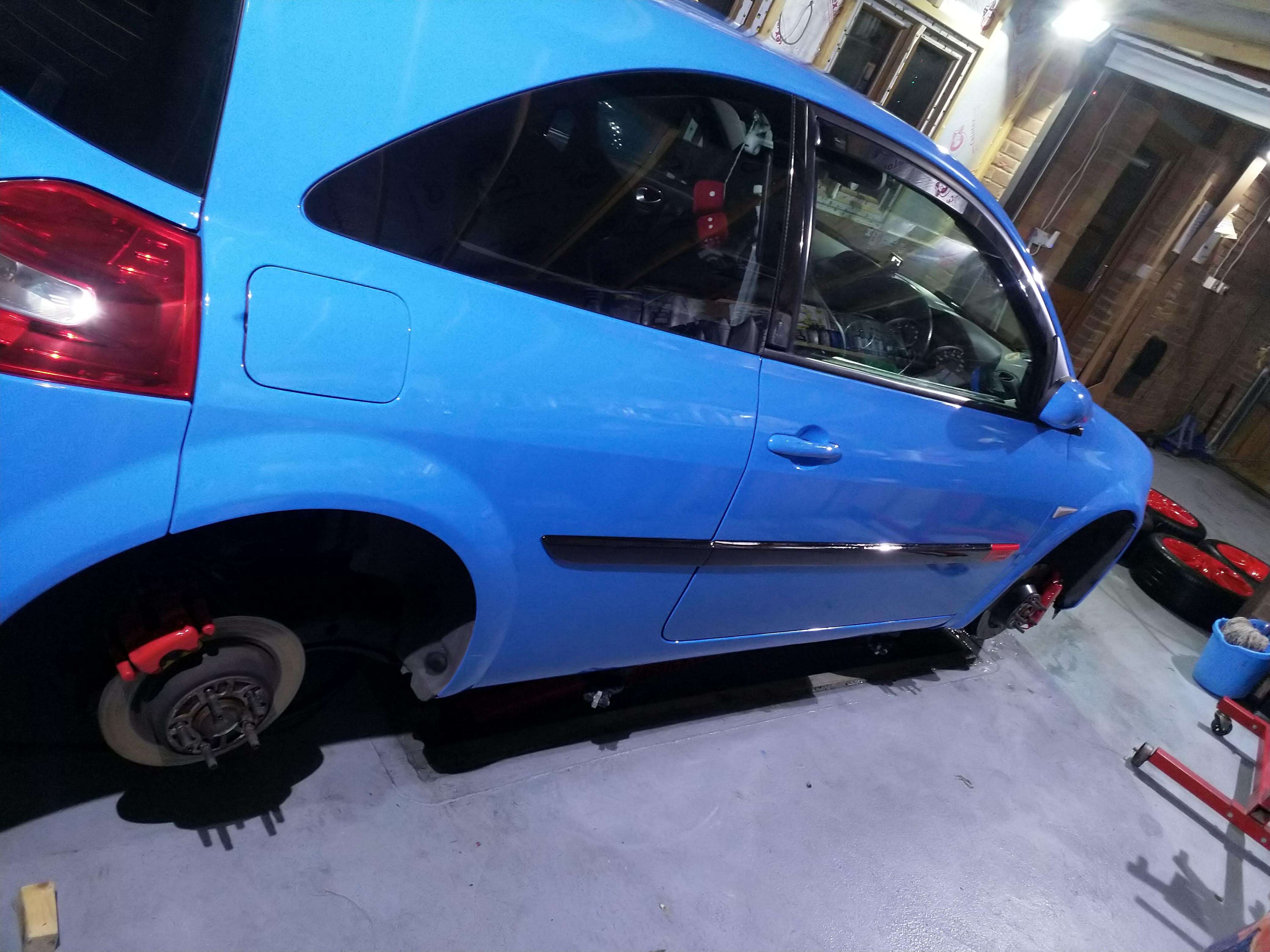

fresh, so stuck it in the the workshop, wheels off to be cleaned and start taking the fuel tank out ready to fit the harnesses! This never got done during the painting stage because to fit them properly is hard work and requires welding to, which means you have to gut the interior!

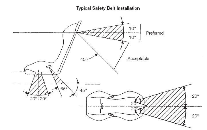

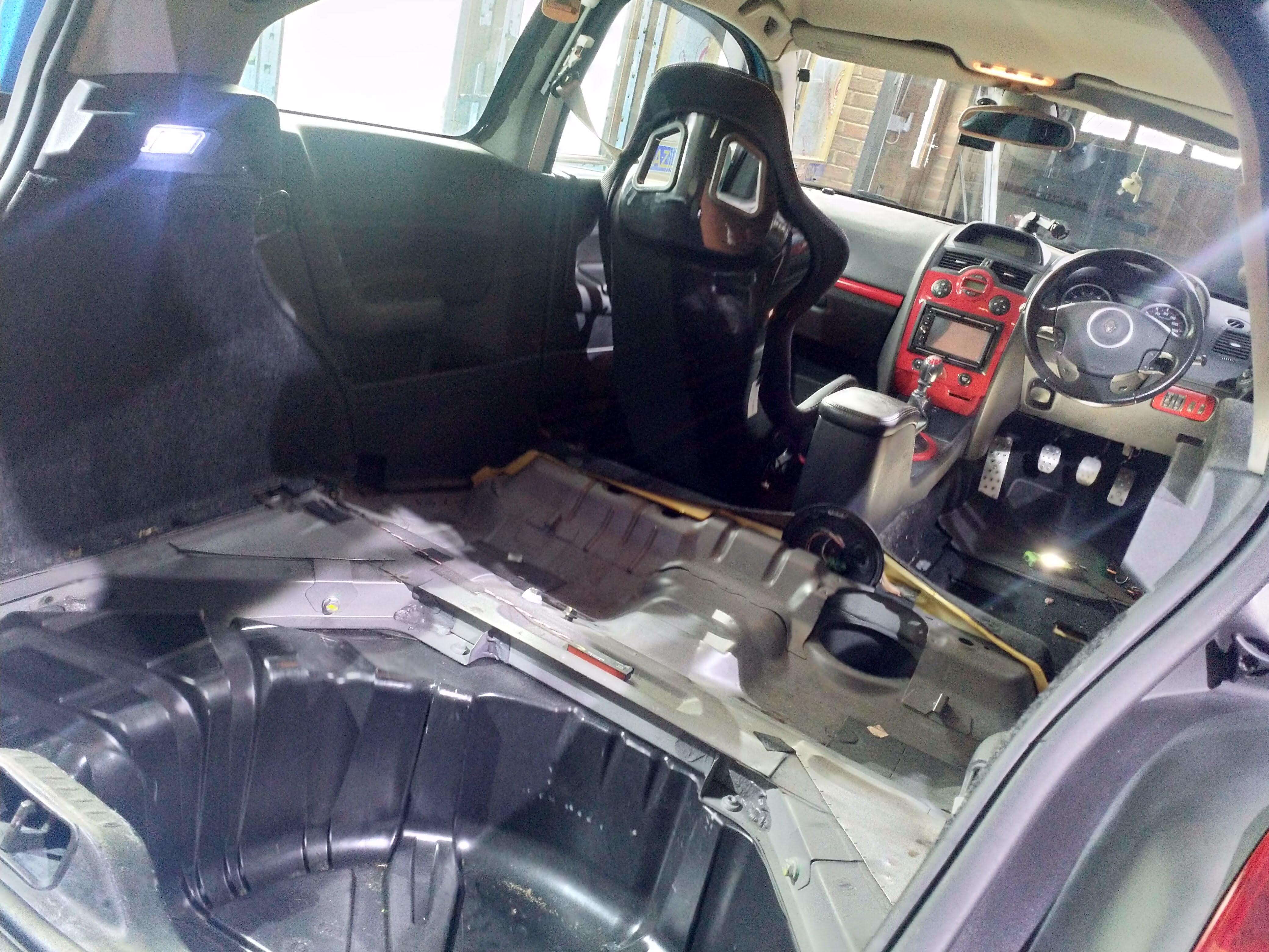

so interior out, chucked a seat back in and got measuring, now luckily there is a proper FIA diagram of what angle the harnesses have to be at, so this make life easy enough, just have to put the seat in and have a measure up with the digital angle gauge, then worry about how your gonna get a plate in there later :lol:

so held some harnesses in place, managed to get the rear at 39 degrees which is a winner, any less i would of had serious issues fitting them! possible need a harness bar or something. The megane will get a roll cage eventually but i can't afford it any time soon cause even ones u weld in yourself are around the 600 quid mark!

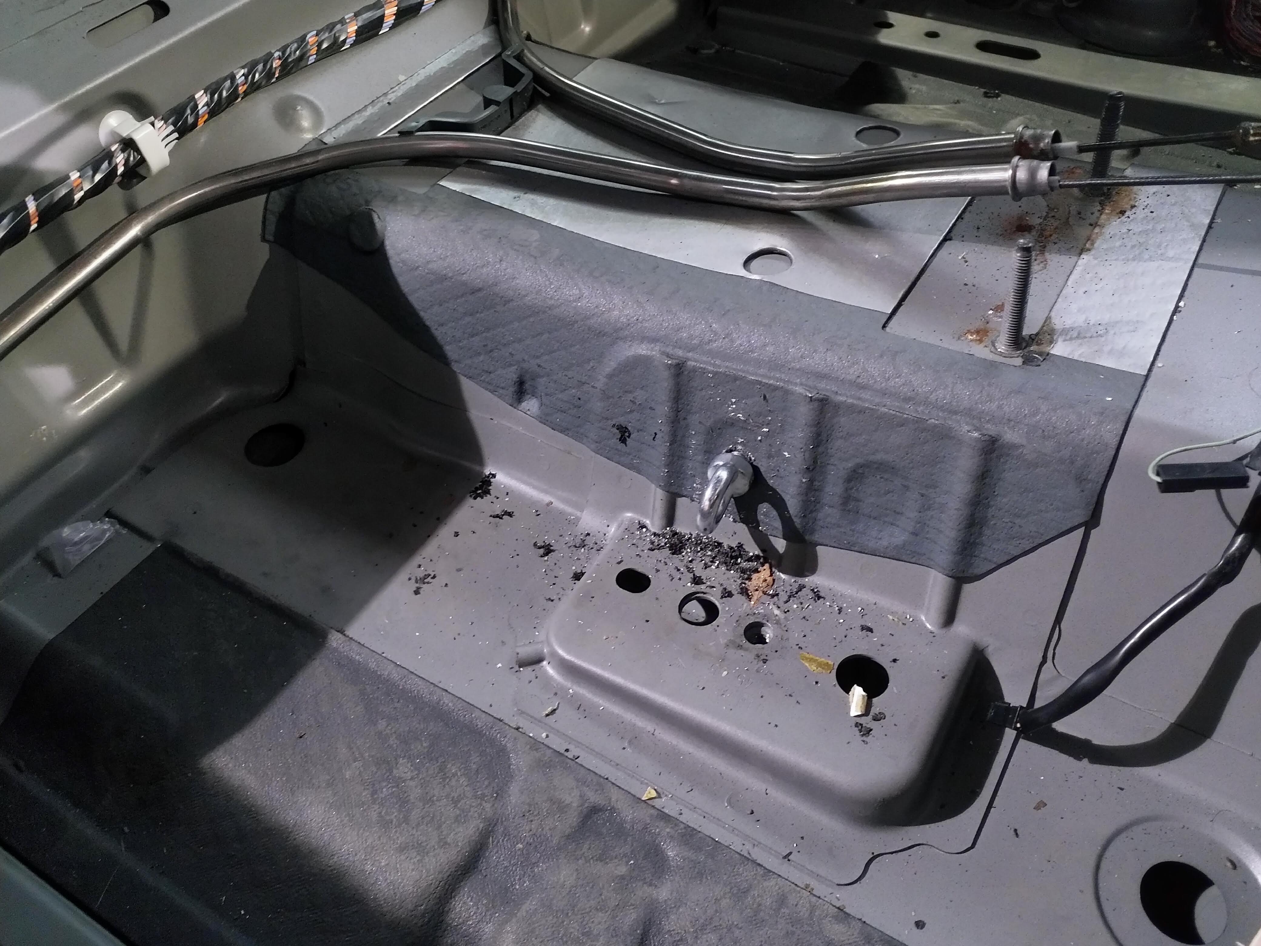

So after a bit of playing around, i managed to order some more eyebolts (made sure they were lifting grade so nice and strong) and use some of the original holes in the car, seat mounting and seat belt mountings, so you can be sure they are nice and strong anyway and designed to take the force of an impact!
so got the rears in

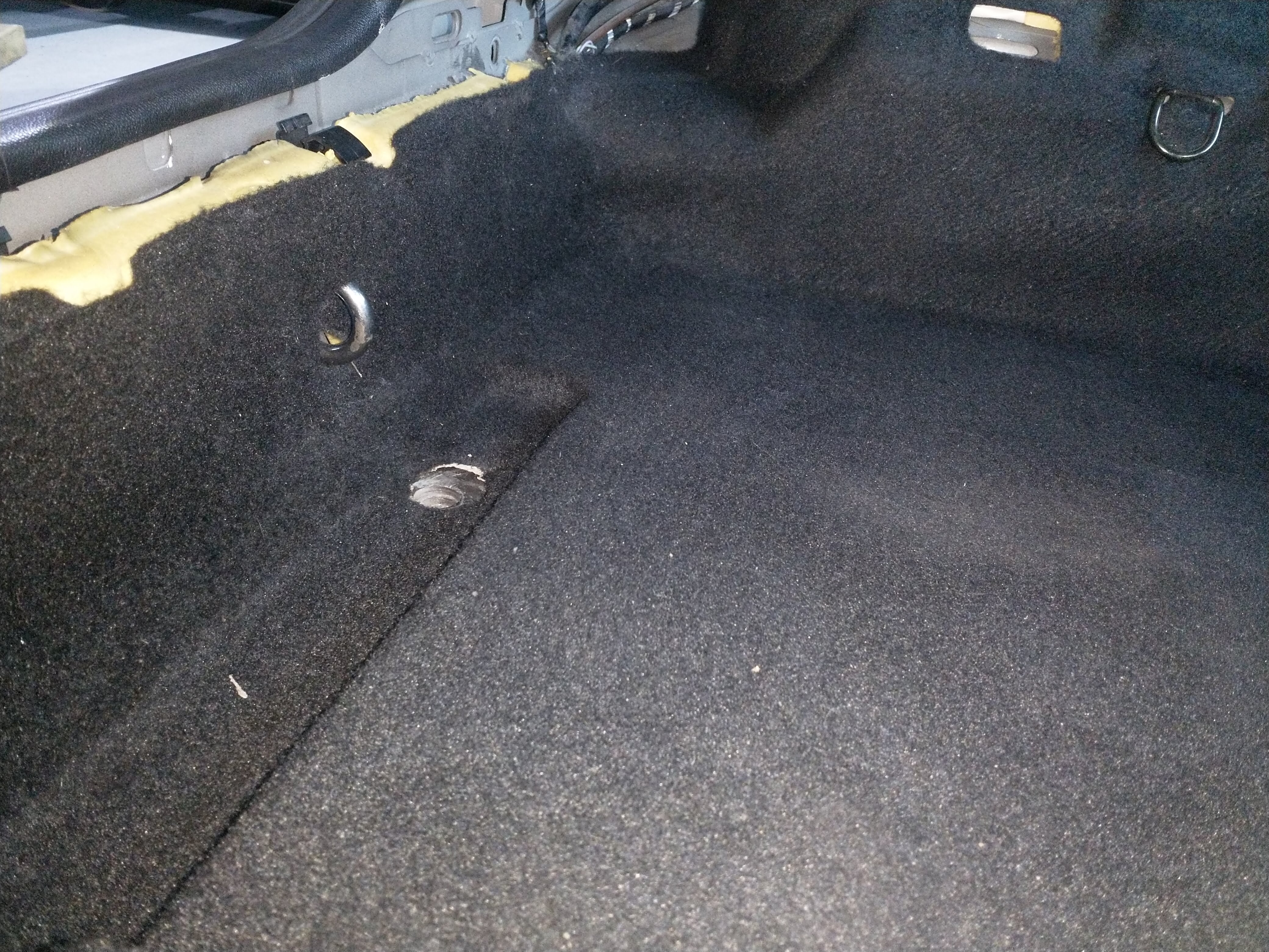

and two in the floor, amy didn't buy 6 point harnesses, but i want them in the eventually for track days etc and while the car is apart, rude not to!

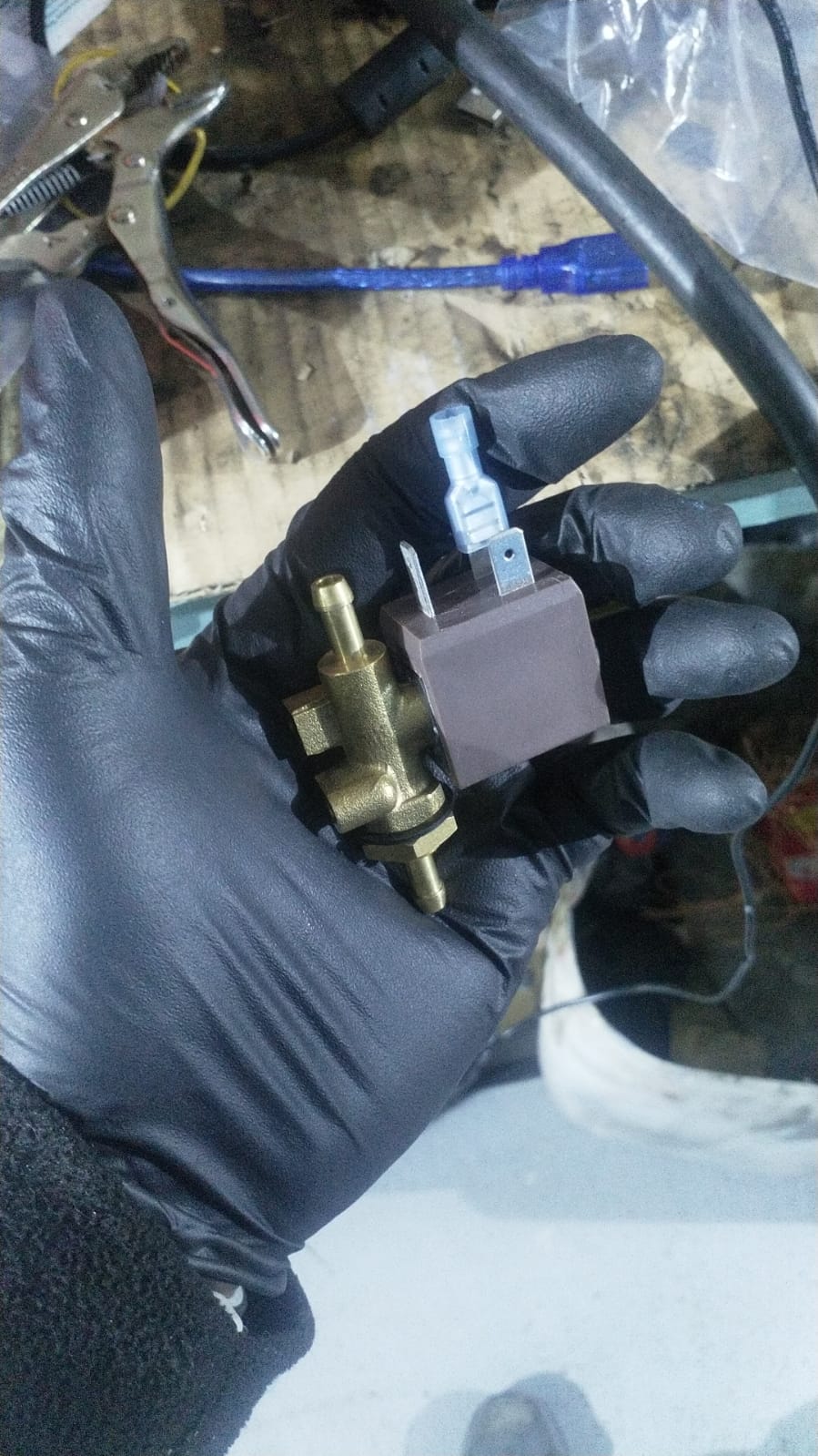

so went to use the welder.....
and it broke

so the welder is all fixed! Basically i wasn't gettin any gas at the torch So once i had a bit of a look at it, got the multimeter out and followed the gas circuit and found a faulty gas solenoid, basically lets the gas in from the bottle when u pull the trigger.
I needed more gas anyway so got some new gas, new solenoid for 15quid and shes was all good again!

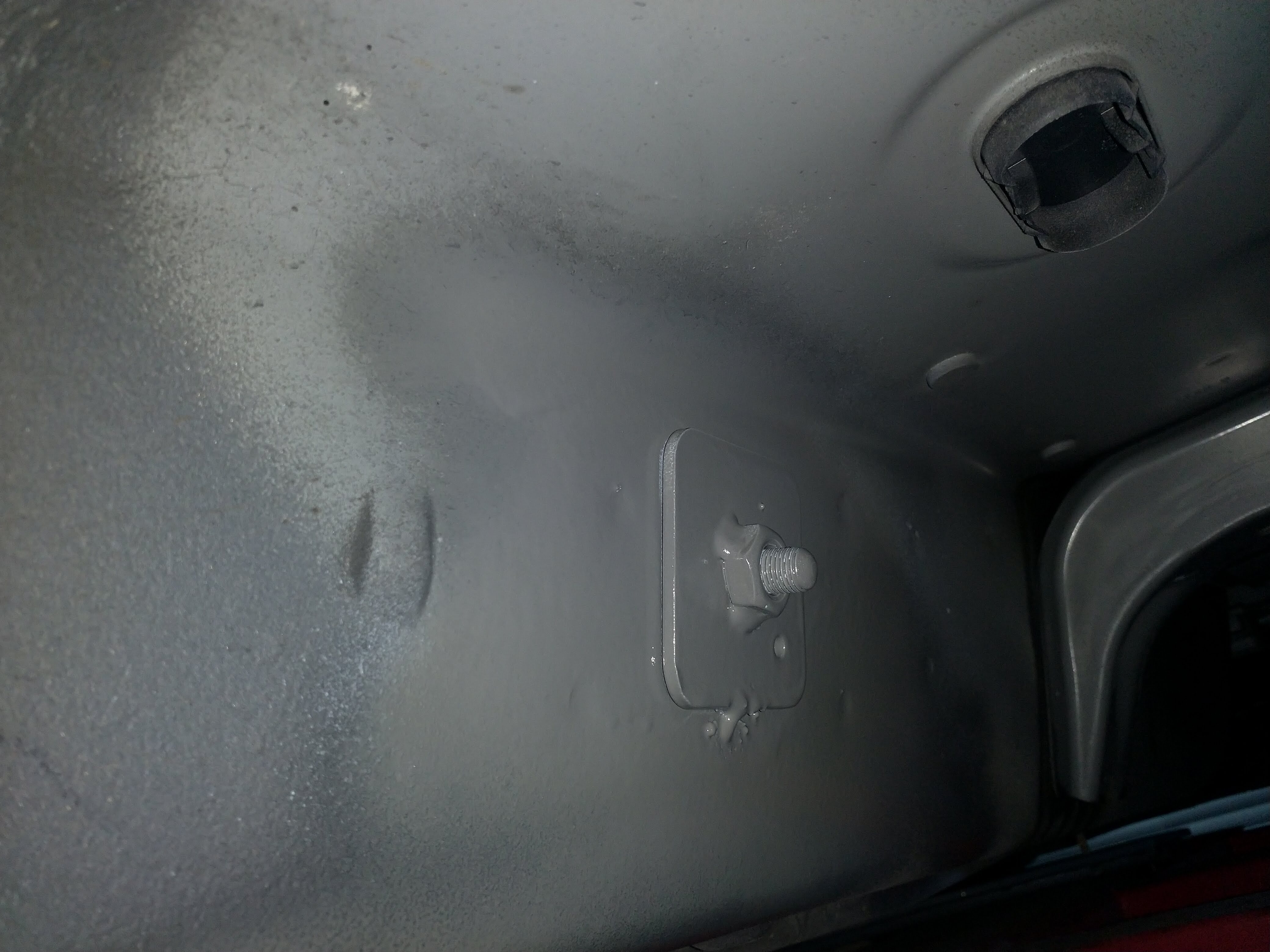

so cracked on, plates fitted, tack welded to stop them spinning, bit of etch primer then a thick overcoat of stone chip. Perfect!
