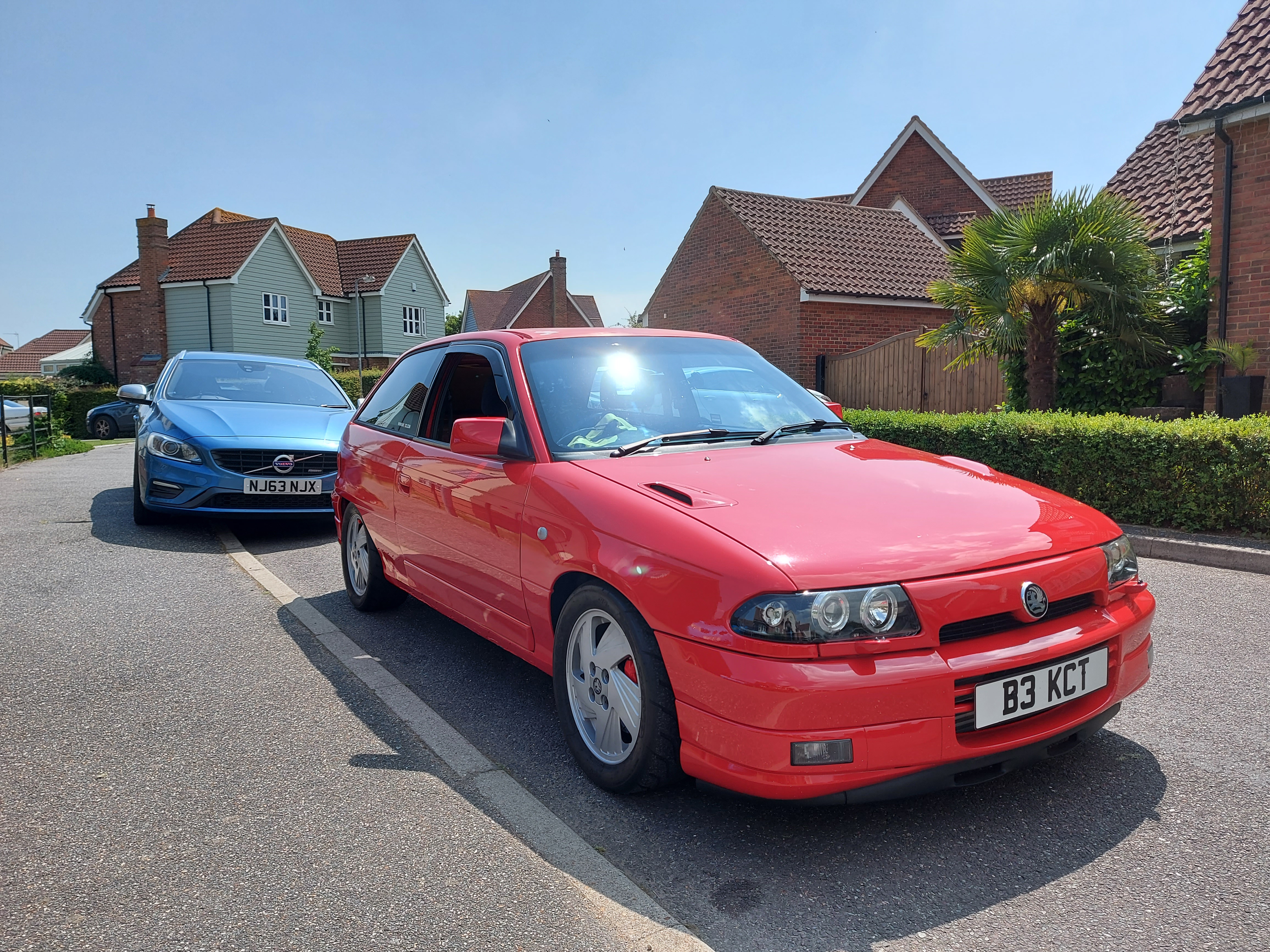

checked over, Filled the tank and waited several days for some decent weather but finally... there was some. Roll on 150 miles of running in round essex...
full
full
Bradwell Power Station
full
Hanningfield drag strip... I mean reservoir lol
full
And done!
full
I managed 120 miles before heading home, also went out the next day for a quick blast so total miles ended up at 139! close enough lol.
139 miles is definitely enough to know if there is any i=issues with the car and it all seemed pretty sound. It needs a big spanner check now. But nothing major to report apart from tracking being off, a few rattles but pretty sure thats the tailgate i threw on, engine sounds strong and smooth, boosts up very quickly. Obviously I didn't smash it, but to bed an engine in the theory now days is just drive it. On off the throttle , load, bit of boost, plenty of overrun cause that cools the piston rings down as the rough finish of the bores makes the rings hotter than regualar.
But i did give it a bit and its very willing to come on boost!
The map needs some work for driveablity but I can sort that out at a later date.
But overall I'm truley buzzing. It all works and its given me the drive to crack on.

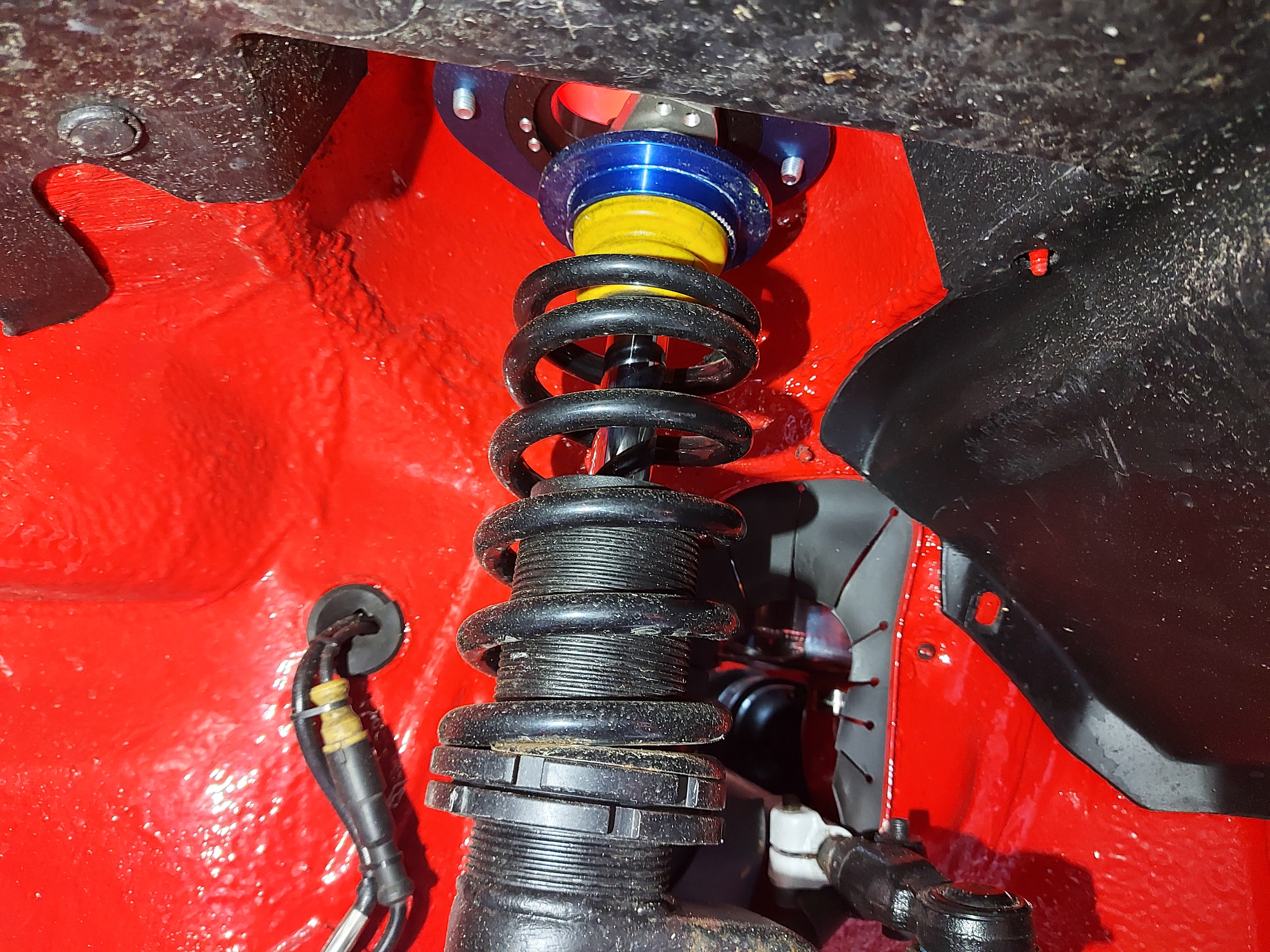

So today i decided to tackle a few more jobs.
First up, fit the helper springs, I have wanted these for years. Not only to keep the spring tight when the car is jacked up, but also allows more damper travel which is always a good thing. You can see what the spring does under full droop ( wheel jacked up )
full
Top nut undone, top cup off
full
I love this about coilover, spring change with the leg in situ :cool:
full
these are only 40lb springs, as apose to the main spring which is 450lb. So with the car on the floor they will be fully compressed. So I compressed the helper spring in a vice and measured it
full
and lowered the spring platform accordingly....
full
Jeez it doesn't leave me much for ride height adjustment :lol: Hopefully this shouldn't be an issue because I was happy with the ride height before,
so it should be spot on!.... eeekkk lol
full
It's ok as long as I don't want to go lower haha.
Did the same to the rear
full
Happy with that, i'll get the ride height dialled in when I get it on a flat floor and the car is all together
